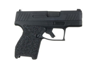

I had about 15 mins of evening light left, so ran a few mags through the new GX4. I wanted to get these impressions down before I forgot. A full review is still to come. Lets begin with my initial concerns:
481068
  • Echoes of the Sig P365 initial issue, also GB guns was first to mention this concern. These are factory S&B 115 RN, do you see the primer issues. Striker drag and swelling, then the smileys on the brass. IMO Taurus needs to bore the chamber out a bit more to provide more case support. I will inspect the striker after a few hundred rounds.
  • Ignore what the super strong reviewers are saying, this puppy is a handful. About 10-20% more felt recoil for me than the Sig P365,,caveat - the grip being better in ergo and stippling are partly to blame. Because it allows you to get a great grip, but the rough stippling will make you feel that dance with physics more. Pay heed - this is not a pistol for beginners or weak handed. My next session I will try the smaller grip module, to see if that changes my impressions. Of course with my shooting gloves - no problem.
Now not all is bad here. No fails in the two mags. I ran both mags full, after letting the mag spring set for 24 hours. No feed or out of battery issues. Accuracy and POA/POI weren't bad..the drift left is my grip..2" left was the 11rnd mag, 1" left was the ext mag,,so its gotta be me. I may drift the rear sight. The slide is about 20-30% easier to rack than my Shield plus. Ejection pattern was strong, trigger is just right for a micro SD pistol. that is all for now...more to come.
