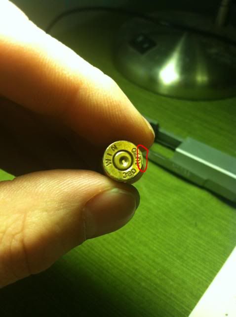

I'm wondering if this is normal. I noticed a weird mark on the casings after shooting, then when I took the gun apart to clean it, it looks like the breech face has a line or mark in the same spot. I'v never noticed it before, and you cant see it when the slide is clean.

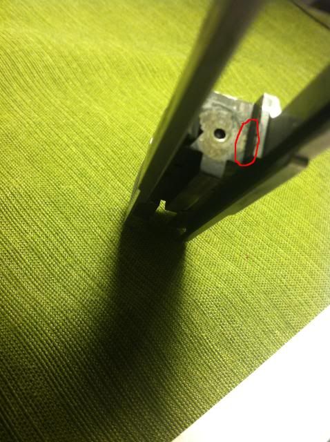

so i cleaned it, and it obviously has a section not machined down on the breech face opposite of the extractor. This gun has about 450 rounds through it by the way.
8,152 Posts
Sure looks like the mill missed the last section.
7,557 Posts
Looks like it either needs to go back to Taurus or if you know someone who does machine work it would be an easy fix

I just got it back from Taurus last week for feeding problems. They seem to have fixed that issue, now it's not extracting very good.

So I sent the TCP back, and got it back this week. They changed the barrel, adjusted the extractor, and ground down that piece on the breech face. Took it out and shot 80 rounds with no problems.
