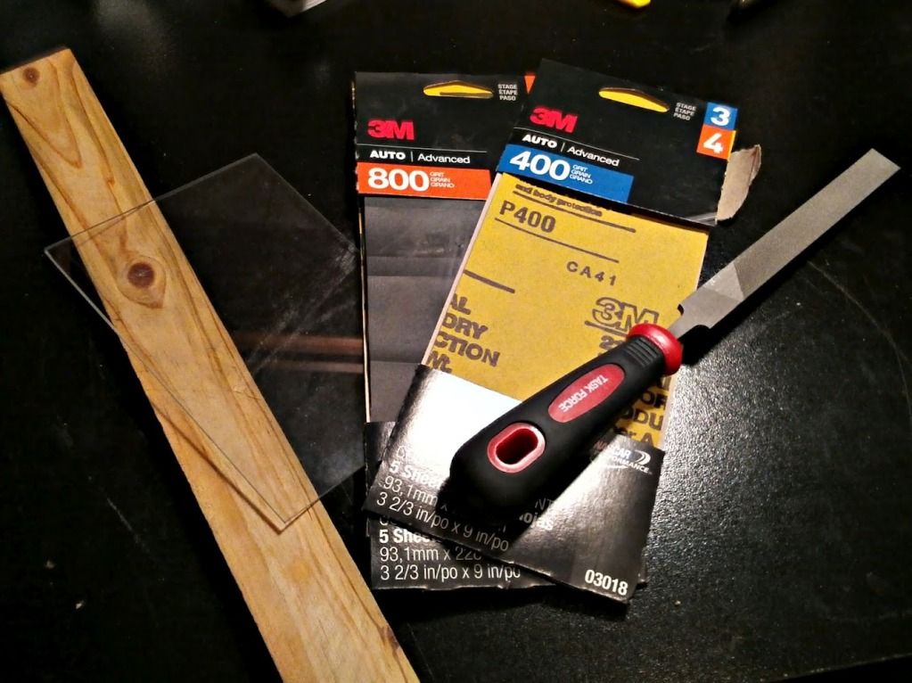

These are the tools you will need for these modifications. The piece of glass was from a picture frame and worked great.

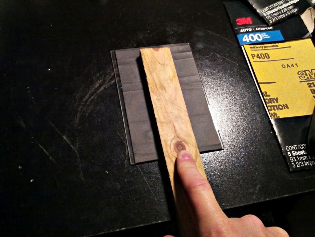

I used 400 and 800 grit sand paper to flatten and smooth the 2x0.5 piece of wood. It took a while but I didn't have anything coarser. You will need grits at least this fine later in the process.

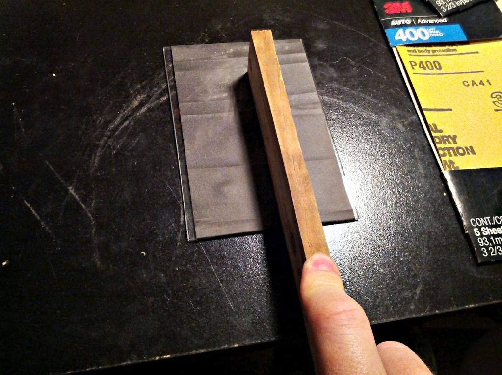

After you flatten and smooth the wide side of your 2x0.5, do the same to one of the narrow sides.

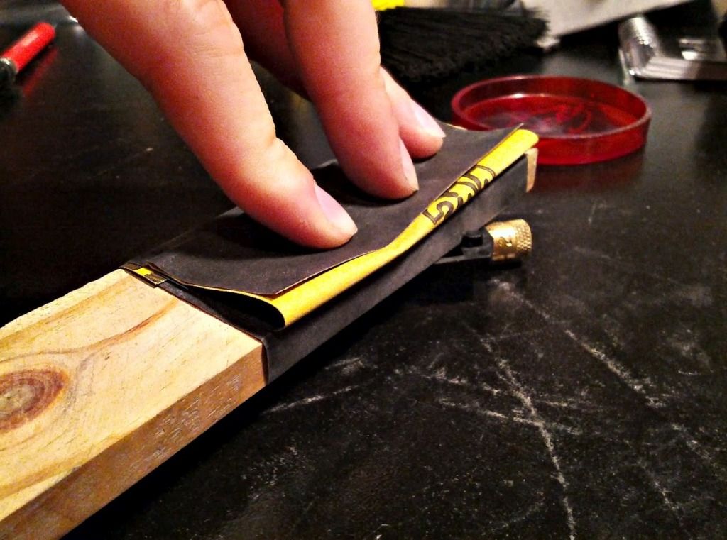

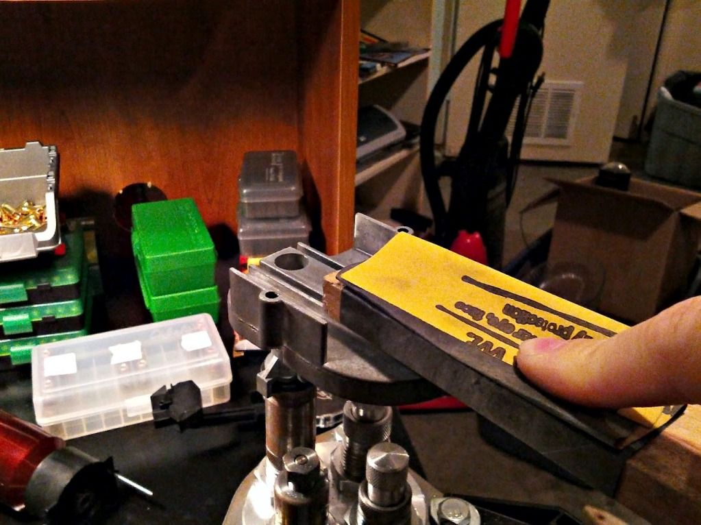

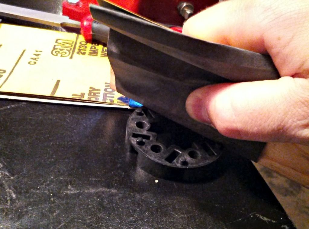

Now wrap the 400 grit sand paper tightly around the wood and sand the base of the powder dropper with the flat, smooth side you made on the wood. Follow up with the 800 grit for a really smooth surface. NOTE: Remove the spring and move the actuating arm out of the way. I had everything back together when I took the pictures.

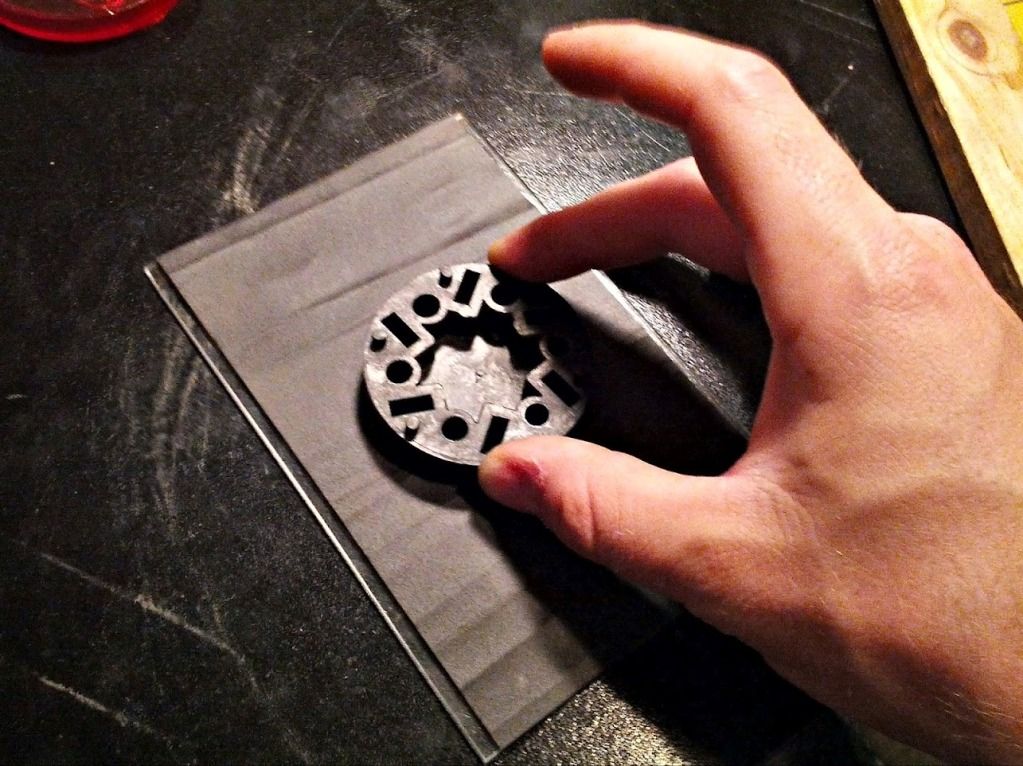

Now sand the top of the disks in the fashion shown. Use light to moderate pressure and circular strokes and follow up with finer grit paper.

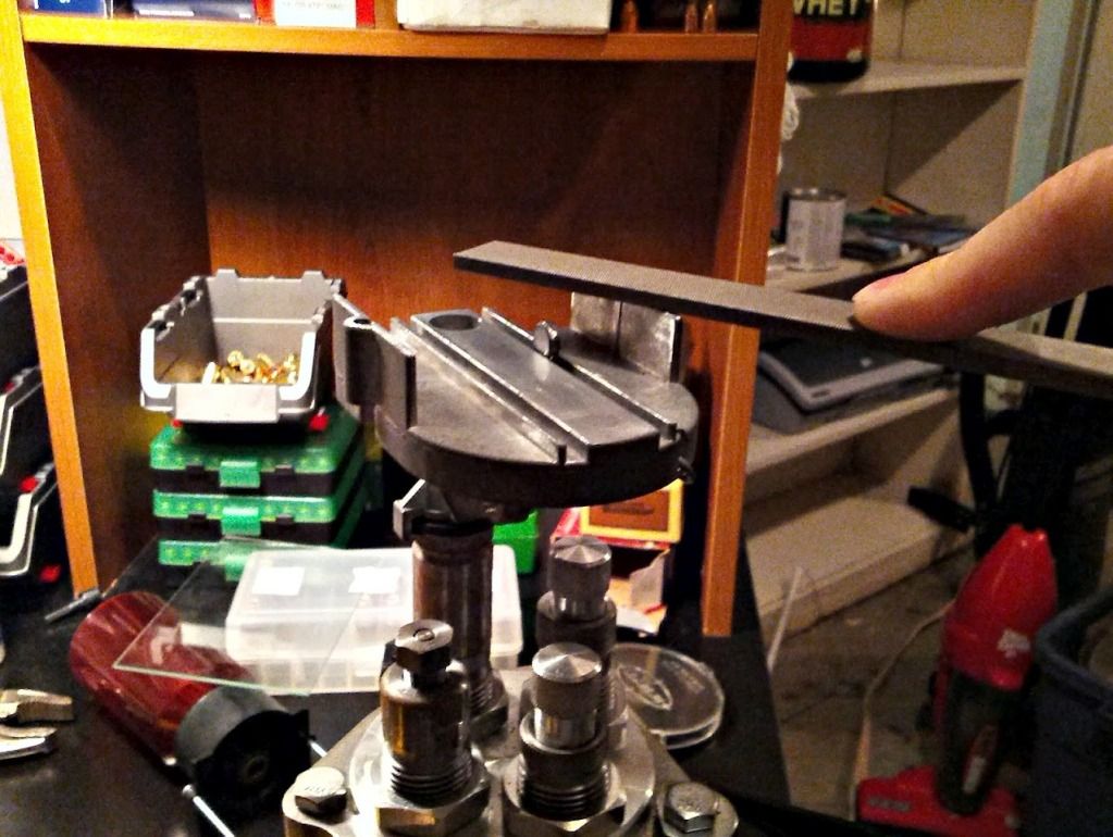

You've made the parts slightly shorter when they stack together, so now you have to file the walls of the dropper base. I probably took off about .005" - .010" from each side. This can be slightly sloppy due to the design of how the hopper, wiper, and disks stack together.

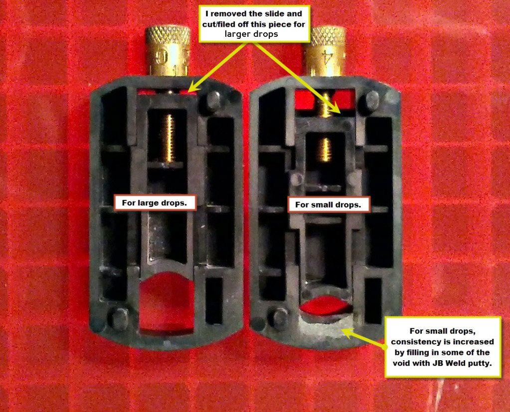

I have two ACBs. One for small drops and one for large (454 Casull loads). These are the modifications I did to them and after smoothing the top and bottom surfaces, they work great. You may want to try these.
NOTE: I have noticed that some of the disk holes now drop up to .01gr lower than they used to. A rat-tail file brought them back to where I had them.
