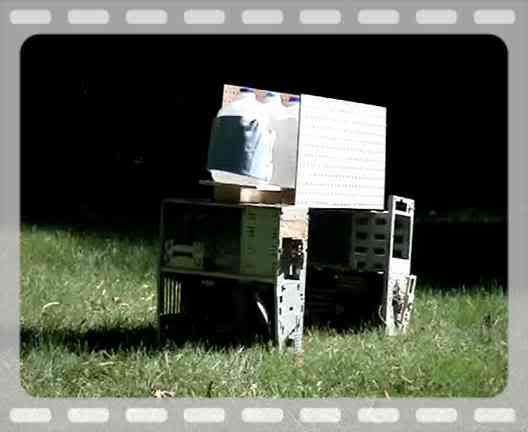

The new setup…
… and the shot.
I found the first jug shredded, on the ground.
The denim went its own way too, with a bullet hole through the middle.
The bullet impacted at 21” of water and bounced back a few inches (lower left hand corner). The jug which it bounced off of was cut.
