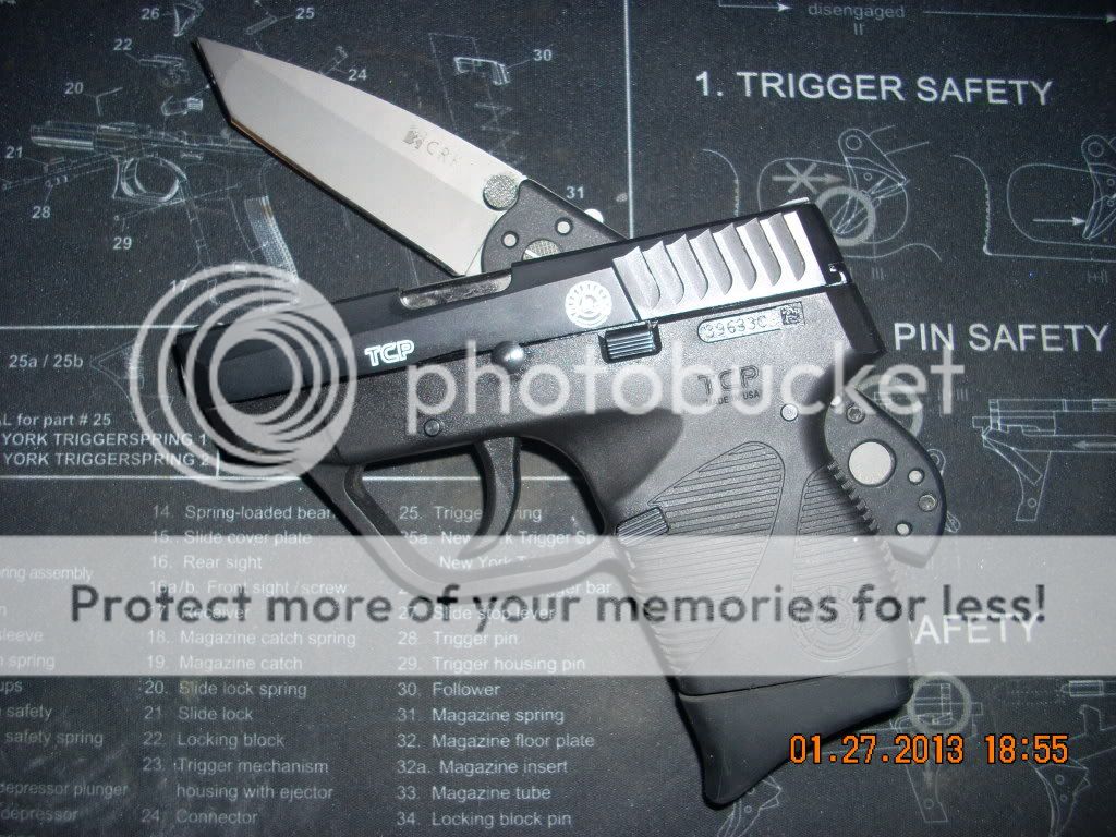

Need a new camera very bad, had to leave the flash on for it to focus, will try and steal the wifes and take some better qualities with it.
Tried out some color infill on the tcp. Just done in wax for now, wasnt sure if I would like it so didnt want it to be permanent This way it is easy to clean out if I decide I dont like it. Very easy to do and using wax you have an almost endless choice of colors through the crayola box.

That sure makes the engravings stand out. I like it.

Nice. I am still trying to get the courage to paint my TCP sights with my daughter's nail polish.

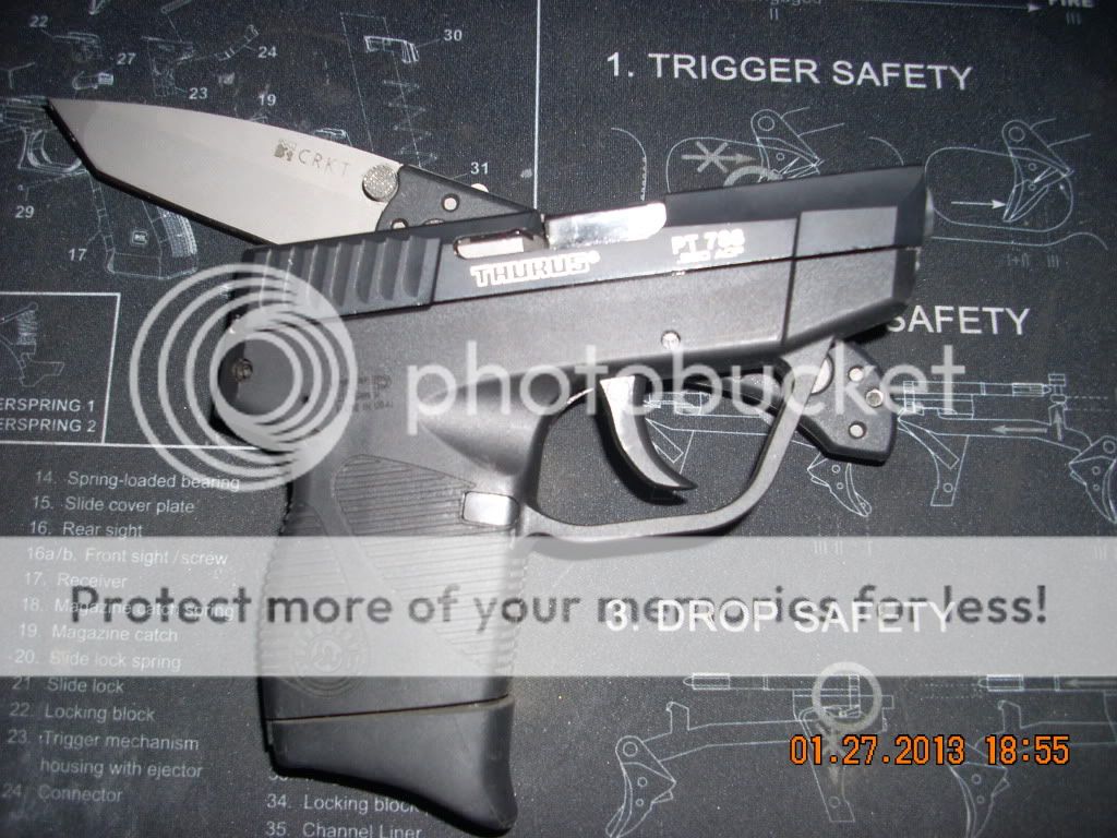

I sandblasted my slide and filled in with black enamel, alng with a few other mods.
As for the sights, I used a Dremel with a cutoff disk and ground out a slot in the front and rear sights, painted the slots white enamel, and filled with some clear epoxy that I added glow in the dark powder to. Results were very good as you can see and are easy and fast on target. The slots allow more light in, just like with fiber optics and from the rear they look just like dots.

Looks very nice, what media did you use on your slide, just sand of glass bead? I do alot of powder coating on the side and have though of powdering mine. Havent done any pistols yet, but have done a few barrels for rifles and shotguns.
12,813 Posts
LOL, I have no idea. I went on post and used the sandblaster at the Automotive Shop. It was probably sand as they just use it to knock off rust, or get parts ready for paint. Powder coating sounds like a good idea, just keep the powder off the rails and breech face. I used Duracoat before, but I think just about any finish will wear over time. I like the sandblast finish because I can touch it up very easily.
But if you are going to refinish the slide, you might as well knock off those ridiculous corners on the front of the slide. That is what got me started on modding my 738. BTW, the extractor is a real pain in the butt to get back together. So if you take it apart, you may want to practice putting it back together a few times before you refinish the slide until you can do it without scratching the finish (or losing those little springs).
