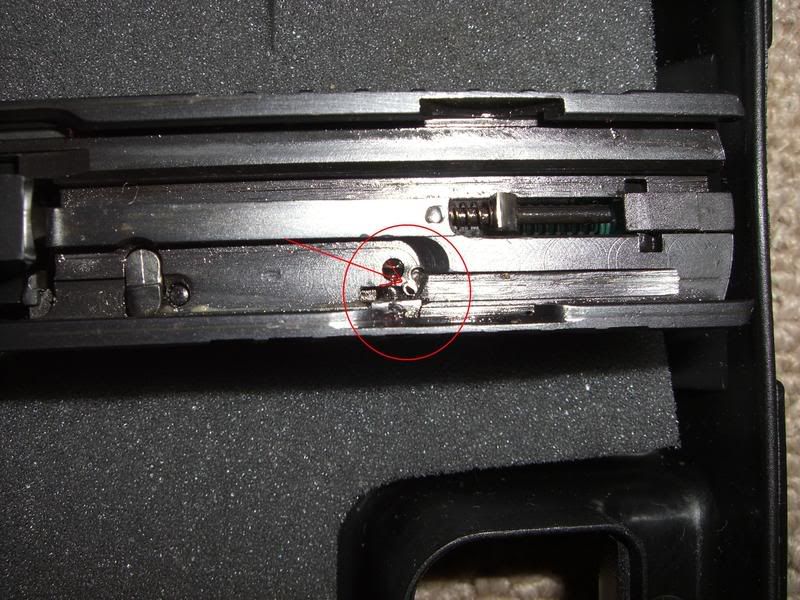

Can you show us the right side of the frame?
Is the finish getting chewed up there?
No, make no assumption it was fired.Goggles said:I suppose 200 rds can do some wear. Had I known to look inside prior to purchase I would have answered my question.
The only real wear it seems is that the silver "tube"or "circle" that is pointed to, is being pushed rearward. The lock is directly in front of it, so I can assume that someone fired the gun with the lock partially on.
Caveat Emptor and chalk it up to a lesson.
It is reassuring to have someone who knows these guns say it won't blow up in my face though. TY. :thumb:
