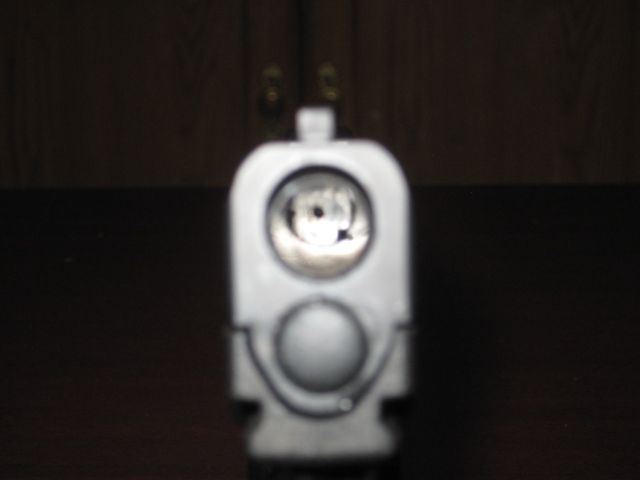

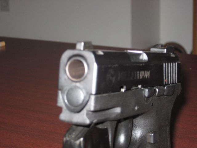

Just bought this, and took it to the range yesterday. Before I even took it home for the first time, I noticed the barrel was off-center in the slide, to the bottom. I didn't think anything of it, until my second magazine. I saw that it was shooting low and left, at about 30ft. Left I can adjust, but I'm unsure how/if I can adjust up and down.
I couldn't find anywhere if this is common, a common problem, or anything. I'm hoping there is something I can do myself, since I'm not going to bother sending it back for warranty work - it's my only CCW and I'm not going to wait however long it takes for this. I have a friend who's more of a gunsmith than I am(ie, I can follow instruction, and am not afraid to take a file to it), IF necessary

Lighting? Yeh, I know that's always tricky when trying to show what a person is trying to explain. I just took these, and hope these better convey what I'm referring too, about the barrel looking low in the slide -
As close to dead-center as I was able to manage ...
And two other pics. Hope this helps ...

Let me expand on that a little bit. When the pistol recoils the barrel and the slide both travel a short distance together as the barrel tips down in the rear. When it tips down it changes the angle to the muzzle and allows the slide to come back over the barrel. And the barrel is pretty loose at that point. Just clear your pistol, and pull the slide back till it locks, and feel how loose the barrel is. Then let the slide go back forward and try to wiggle the barrel with your finger and it shouldn't move unless the slide moves with it.
When it goes back into battery as the rear of the barrel rises the muzzle again finds the bottom of the hole where the muzzle is locked in place. You want the muzzle to return to the same spot every time, and that's going to be the bottom of the hole. Maybe not the exact dead center to the micron bottom, but pretty close. As long as it returns to the same spot every time all is well. Probably why the sights are adjustable, and they generally don't take too much adjustment for windage.
There's also two sights in dovetails, and getting them centered on the slide can be challenging. You could have on off the one side a tad, and the other off to the other side a tad, and you'd barely notice it until you shot it.

AHhh, Alright, that explains a lot. Thanks! Basically, I'm overreacting ... lol While I'm not new to guns, this was a first for me, but your explanation cleared it up quite a bit. I'm still going to check into those sights tho ...
