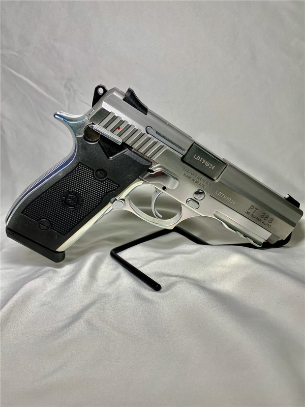

Have been looking for a deal on a PT 38S and finally got one. Estate sale, mint with everything it came with at a great price. Should have it in a few days. I only have one other 38 super but on the PT 38 I was wondering if it handles 38 Super +P ammo or just standard 38 super? Thanks!

Sure is a handsome pistola! :thumb:

Congrats! It looked like a good one. :hand2:

Beautiful pistol by the way,

Wow...:blink:...it's like Brigitte Bardot with hand grips!
