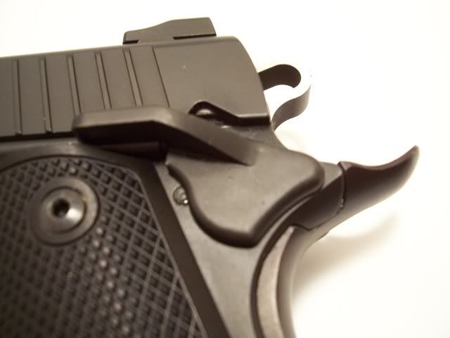

Nowlin Pro hammer, dropped in with no fitting, using the existing hammer strut and sear. So far, so good. It was installed to rid the gun of the defective ILS.

I don't know, but looking at the picture at the right side thumb safety, I always thought the right side thumb safety tang was supposed to go under the right side grip. This one appears to have the grip under the tang. Nor does it appear that the right side ambi-safety is flush against the frame, meaning the left and right thumb safety parts are not properly "mated" together.

Maybe it's the picture, but the tang is most definitely is under the grip and the safety is flush with the frame. And, yes, the ILS is the Taurus locking system. Mine failed after one range trip.

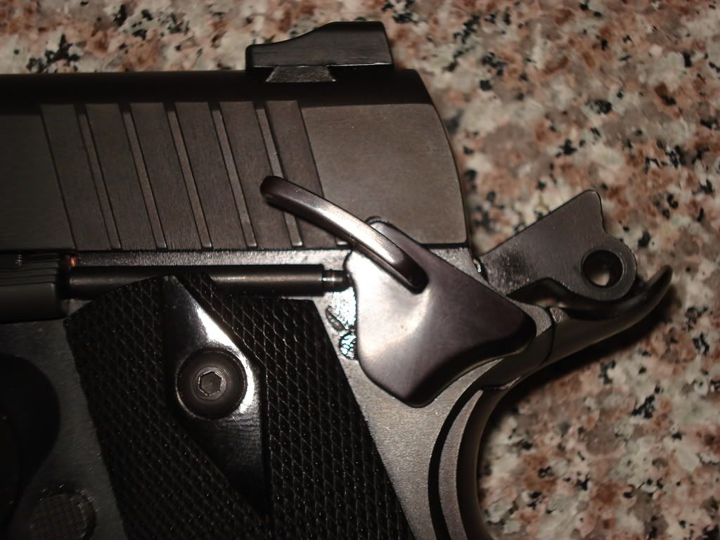

Due to an issue with the ambi safety I replaced it with a Wilson wide safety. Okay I had the smith do it.

How do you like the new Wilson safety starshooter?
Do you have any more clearer pics?

The new Wilson safety was totally worth the cost. Here are a couple of better pics of the safety.

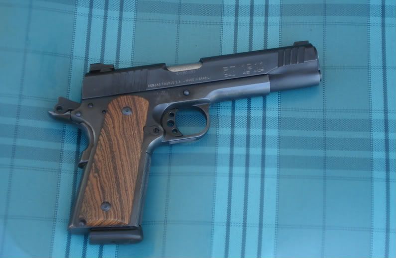

Here are the new grips I got for my PT1911. Hope you like them. I know I sure do.
