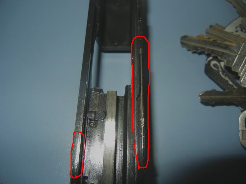

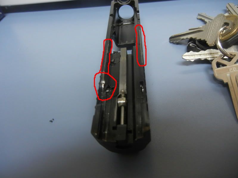

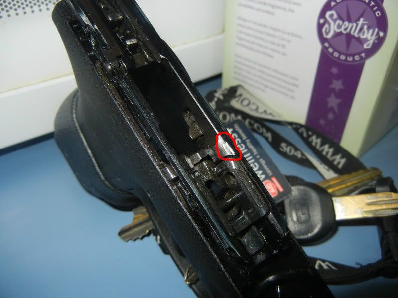

I'm a proud new owner of a Taurus PT640 Pro as of a week ago and this is my first personal firearm. I spent 3 hours cleaning it the night i got it, and i shot 80 rounds through it the next day, cleaned it again after that, and noticed this. I pushed it off figuring it is "breaking in" and continued on, and i decided to clean it again (i use m-7-pro btw) before i went to take it out again today and i put about 100 rounds through it without a problem, and while i was cleaning it today looking at this again its just bothering me and i would rather ask before i worry and send it back to taurus if this is an issue. I dont believe i am under-lubricating as i am generous but not too generous with the lubricant but it just seems like this is what would cause it? Any help would be greatly appreciated.
P.S - these pictures were taken before i cleaned it tonight.

I can see the pics and see where your concern is. I think the area where the bluing is slightly worn is normal wear and tear but the gouging doesn't look good and ultimately might leed to something hanging up. Are there burs anywhere on the frame side? Something looks like it's biting into the slide at some point in the action.

The area inside the smaller circle is caused when the slide pushes the disconnector/trigger bar out of the way. It's not bad now, but it's an area to keep an eye on. On the other side, it appears you have a burr on the mini frame just a little forward of the magwell that seems to correspond to the mark. A little work with a needle file to knock the burr off might not be a bad idea. I had a couple spots on my PT145 that appeared during break in, and for the most part they wore to the point they were going to and settled down. Always a good idea to keep an eye on those kinds of things, but it doesn't look like any huge problems. If the slide starts getting difficult to remove, the area inside the small circle is the place to check. Here's some more info on it - PT145 slide getting hard to remove? Here's the fix

After i shoot there is small amounts of burring. the only time it was giving me trouble during an action movement was the other night when i broke down to clean it, ever since has been fine while sliding, etc.

I'd definitely get rid of that little burr. While it may not do much harm in that location, it's not going to do anything any good, either. If it was mine I'd file off just the burr, being careful to only remove the burr. If you don't have needle files, Craftsman makes a decent set for not too much money. They come in real handy. JAT

It's always good to pay attention. Just for grins I took my PT145 apart, and I have a little wear mark in the identical place as the 'big circle' mark on yours. That happened the first couple times out, and I kept knocking the burr off 'till it quit doing it. Which didn't take too long. I've got about 1500 rounds through it, and it hasn't gotten any worse since the break in period. I guess that's why they call it break in - sometimes you've gotta break 'em a little. :D

I took mine apart again, and I changed my mind about the burr. Still knock it off, but it isn't what caused the scratches on the underside of the slide rail. The marks on the mini frame are caused by the barrel settling in. The marks under the slide rail are probably caused by the back of the slide release and possibly the slide stop itself. Got the same marks on mine. Nothing to worry about in that location, as that part of the slide doesn't really do much. You might check the slide release and the slide stop (or take down pin, as some folks call them) and make sure you don't have anything obviously wrong there, but again I think it's just normal wear.

Third pic looks like a burr.
Here is what my 24/7 looks like, same as yours but no burr.
about 2000 rounds through mine, the rails are showing some wear, but not like yours.
