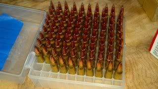

Well I finally did it. I have had my Lee pro 1000 partially set up for a few weeks. I deprimed and sized about 2100 pieces of brass, with most being military. Over the weekend, I set up the powder dispenser and practiced throwing charges and weighing them. I am using Ram shot Tac and CCI primers. I decided on using a single disk with the 1.57 hole which averaged around a 23 grain charge. It would sometimes go up or down most .5 grains which I'm not thrilled about, so that's why I kept it low. The range for Tax I found was 22.5-25grains. I loaded up 100 primers in the tray and started working. It was slow and almost painful with the number of primer seating issues. I probably dumped 5-6 charges when the primer didn't seat and I didn't catch it. It would have gone faster using a hand primer and a powder drop and funnel most likely and would have been less messy. I ended up with 88 rounds that I weighed and measured the length on, 2 that the bullet seated wasn't adjusted correctly and the bullet is way deep, and 2 that didn't get charged before seating the bullet. The last 8 primers were casualties. I guess that isn't terrible for a first run. Of course many said a lee progressive wasn't the best choice for a beginner and they are correct. But I tried anyway. I do have a shell plate for 45 coming.g soon, so hopefully loading pistol rounds will go a bit smoother. I don't have a chrono yet, so I am just looking for plinking grade ammo right now at short distances.

Discussion Starter · #7 ·
I ran some of my first batch today. I just shot 20 that were 55g fmj over 22.5gr of Ramshot Tac with CCI small rifle primer. I didn't shoot for groups at a target, but rather some bowling pins. I hit every pin on every shot at 25 yards with my new AR pistol. I didn't get to shoot many more since we were short on time and my buddy brought his Savage 338 Lapua Magnum with some loads me made using a new powder.
