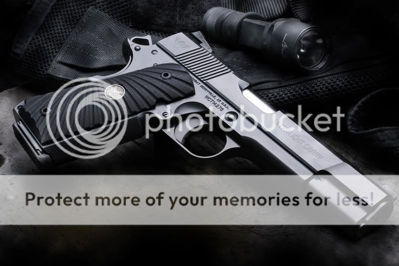

Make sure you tape around the dimple if you have a black gun to minimize any small scratches. Use a small piece of emery so that it doesn't leave swirl marks on the frame mine left a bit of marks that I removed with emery cloth lightly polished along the frame since mine is stainless and it looked like new, I've attached some pictures of my 1911 along side Wilson Ultralight Carry pistol for comparison I would never countersink my frame if it was aluminum but the Ultralight is, the people at Wilson Combat told me that their engineers calculated that it would not compromise the structural integrity of the frame. :???:.
