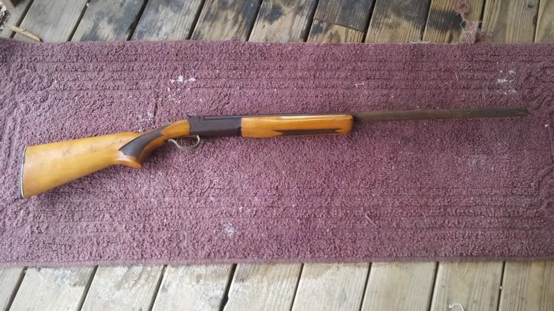

So I was about to lay down for my mid-afternoon nap when one of my aunts called me. She was cleaning out one of the closets of her fathers old house when she came across an old shotgun sitting in the back. She remembered how it got there, but it's not exactly under the best of circumstances so i'll skip the back story.

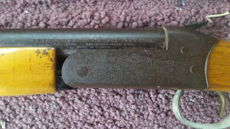

It's a 1971 Winchester Model 37A single shot 12 GA. chambered for 2 3/4" - 3" shells. Of course after sitting in the closet for about 30 years, there's surface rust coating the barrel and receiver and the front bead is missing. I rubbed it with a little motor oil to show the engraving and stampings on the barrel at least. Now to find a gunsmith to possibly refinish the bluing and make sure it's in proper firing order. It's always fun to get free guns, even if it costs me $100 or so to get it back to right again. I'd like to keep the furniture just as it is, mostly because I believe it adds character to a gun.

Nice find, and nice of her to think about you!
I agree, I like character in a firearm as well!

After looking up the possible value of the gun, I think is might be more worthwhile to make this a refinishing project of my own. I finally got the barrel open after using some penetrating lube to break the outer seal of grime and corrosion. There was about an inch and a half of plaster flakes built up inside, but the hammer cocks fine and the firing pin still extends with no problems. So my next step will have to be removing the stock and getting down to cleaning off that rust on the exterior.

0000 steel wool, gun oil and elbow grease. It takes the rust off and leaves what bluing is still stuck on there. Don't use sand paper it will take the bluing off!

Neat find! I just got rid of it's predecessor, the Winchester 370, to help fund a Taurus purchase. Your 37A is a little better built than the 370 (both built in Winchester's Cobourg, Ontario Canada factory). The ultimate find would be a Winchester 37. It's the original, pre-Canadian model, and it's built like a tank! By the way, you can get an owner's manual for it on eBay for around $7, and there are spare parts to be had on GunBroker if you should need them....

You might try bronze wool vs steel wool.. Its a little more forgiving.
Sometimes homedepot or lowes might have it. or Brownells BRONZE WOOL - Brownells

If you use steel wool be sure to use a magnet on the parts you have "wooled" If you go to Grainger they should be able to supply you with the equivalent in "scotchbrite" with the same roughness. If not grainger then a metal refinishing shop. Steel wool leaves miniscule pieces of steel that will rust.

Hey, that's really nice! A little work and she'll be looking good as new! I'm like you, I like the stock as she looks...Lucky guy
