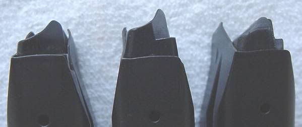

What I have learned is that there are at least three versions of 12 round .45 ACP mags for the 24/7 Pro.

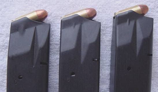

The photo above shows a “First generation” on the left. A “Second Generation” in the middle and a “Third Generation” on the right. Notice the subtle differences:
-The 1st gen has a narrow vertical V groove compared to the 2nd and 3rd gen mags.
-The 2nd and 3rg gen have a much smaller well defined support rib at the base of the mag lips. The 1st gen rib is more of a rounded hump.
-The 2nd and 3rd gen mag bodies appear to be identical.

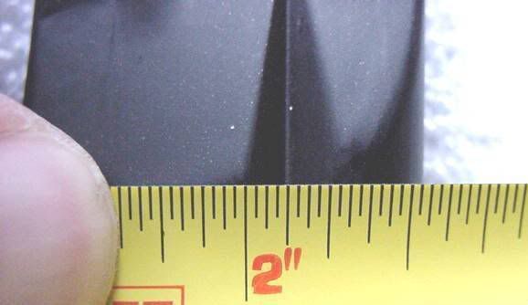

Here we see that the 1st gen groove width is about ¼” wide.
While the 2nd and 3rd gen mag bodies measure almost a 7/16” wide groove width.

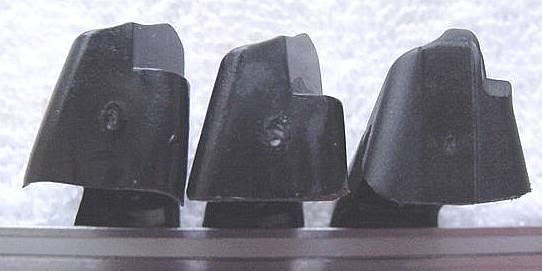

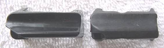

Now to the followers:
Looking from the front, notice:
-The 1st and 2nd gen followers are very similar but the 2nd gen sits much higher in the mag lips. The top surfaces are identical but the shelf on the right side in this picture is taller by .050 on the 2nd gen than it is on the 1st gen.
-The 3rd gen is a totally different follower as we will see.
Here we see the difference in the shelf height between the 1st and 2nd gen followers that allow the 2nd gen to sit higher in the mag body.
-The 1st gen shelf height measures .325”.
-The second gen shelf height measures .375”.

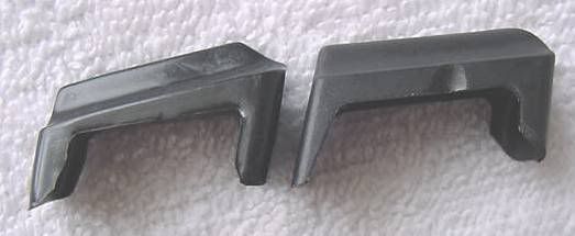

-Note that the 3rd gen follower has a vertical groove on the front face. That same groove is also found on the rear face. It appears that this groove relief was added to insure that the sprue left from the injection molding process does not extend to the front and rear vertical faces...possibly resulting in a jammed follower.
-Note that the 3rd gen top face is totally different with a much wider more rounded contact surface for the cartridge and a much smaller shelf height with a ramped shape.
Also note the bottom edges of the followers:
-The 1st gen has very sharp edges that might be susceptible to jamming.
-The 2nd gen has more rounded lower edges.
-But the 3rd gen are obviously reshaped with a large radius to avoid jamming.

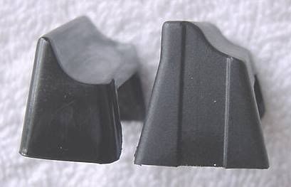

Here is a better view of the vertical groove found on the 3rd gen that is absent on the 1st and 2nd gen.

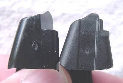

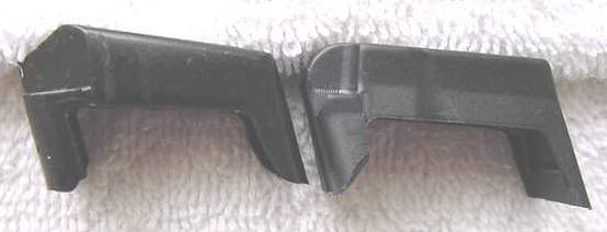

Here we see the difference between the 2nd and 3rd gen follower looking from the left side.
-Note the rounded nose of the 3rd gen follower on the right and it’s smaller shelf compared to the 1st and 2nd gen followers having a larger shelf and sharp angled edge on the nose.
-Also note (although hard to see) that the 3rd gen follower on the right has a vertical groove on it's left face that is not found on the 1st and 2nd gen. This appears to be an alignment groove to follow the wider vertical V groove of the 2nd and 3rd gen mag bodies.
Here we see the rear view and the rear vertical groove of the 3rd gen and the distinctively more rounded shape of the top surface compared to both the 1st and 2nd gen followers.
Here is the 2nd and 3rd gen followers from the right side.
-Again note the rounded nose of the 3rd gen compared to the sharp angled edge of the 1st and 2nd gen followers.
-Also the 3rd gen has another vertical alignment groove on the right face to align with the V groove of the mag body.
-You can also see the rounded bottom front edge of the 3rd gen.

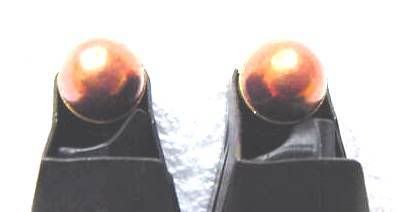

Here you can see a clear view of the follower tops and the rounded 3rd gen profile compared to the sharp edged 1st and 2nd gen profile. The relief of the right and left sides are clearly seen here on the 3rd gen follower as well.

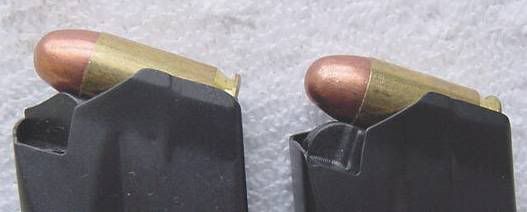

Here we can see how the rounded 3rd gen follower on the right improves the contact with the cartridge casing .
-Note how the contact surface of the 1st and 2nd gen on the left would tend to push the follower sideways against the mag body possibly contributing to a jam.
-By contrast the 3rd gen contact surface is closer to the follower centerline placing less side thrust on the follower.

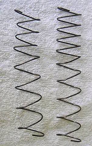

Finally, there is a difference in mag springs.
-The 1st and 2nd generation mags use an 8-coil spring with a measured .053” wire diameter, as shown on the left.
-The 3rd generation uses a 10-coil spring with an insignificantly larger .054” measured wire diameter.
-There is a definite increase in felt spring pressure with the 10-coil spring installed.
