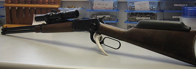

    Ahh... another R92 owner! I have the Puma Scout Rifle in 44 Mag and love the little beast. The best advice I've found was in Steve's video on how to clean the gunk out of the rifle and then lubing up the action by cycling it about 100 times. The difference in my rifle after these two steps was night and day.
    You need to remove the barrel and forearm band to remove the forearm. If your rifle has a sling swivel stud on the forearm stud on the forearm band, BE SURE you place a punch or screwdriver through the stud and back it out a couple of turns. This isn't a blind rivet attaching it like most other manufacturers use, it is thread on. If it remains tighten down you will tear up your forearm. Pay attention to the screw orientation as well. Which way they enter. You might need to remove the magazine end cap to remove the bands, it depends. It is always a good time to clean the tube and replace the magazine follower with one from Steve's.
    Most of the Rossi finish can be removed with mineral spirits. The wood is then open for any type of finish you prefer and everyone I have seen is a handsome rifle after the work.

    Nice,
    What scope are you using. Cabela's salesperson talked me out of buying a scope ($130, lower priced, to be clear) saying the .44 mag would very probably destroy the scope... I have the rail from Rossi, but now have backed off adding the scope...for now. Earlier posts sugggested I shoot .44 special which I plan to start doing....maybe this ammo would be easier on the scope? Your thoughts, suggestions ?

    It is a NcStar 2.75X28. So far so good. It seems to be a Chinese copy of a Burris 2.75 X 28 except with a 30mm (larger) tube vs. the standard 1" of the Burris. I actually bought the same rifle in 45 Colt today and order another one of these scopes.
    See this topic I wrote concerning scout scopes: Rossi-Rifleman.com: Scout Scopes
